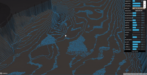

在进行WebGL开发过程中,我似乎发现了N卡的精度问题
我在mapbox上做等高线渲染时,我似乎发现了N卡的精度问题。
When I was doing contour rendering on Mapbox, I seemed to find accuracy issues with the NVIDIA GPUs
render contour with GTX 1650 AND RTX 4050

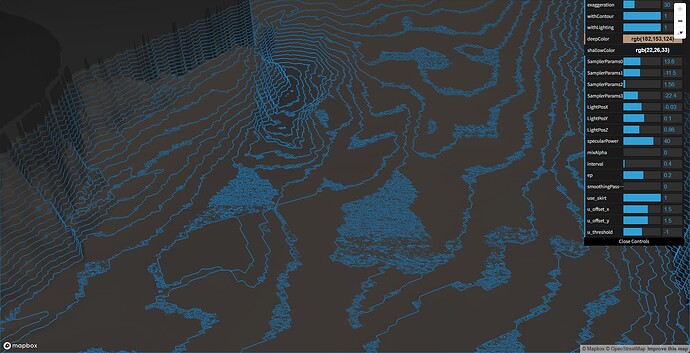

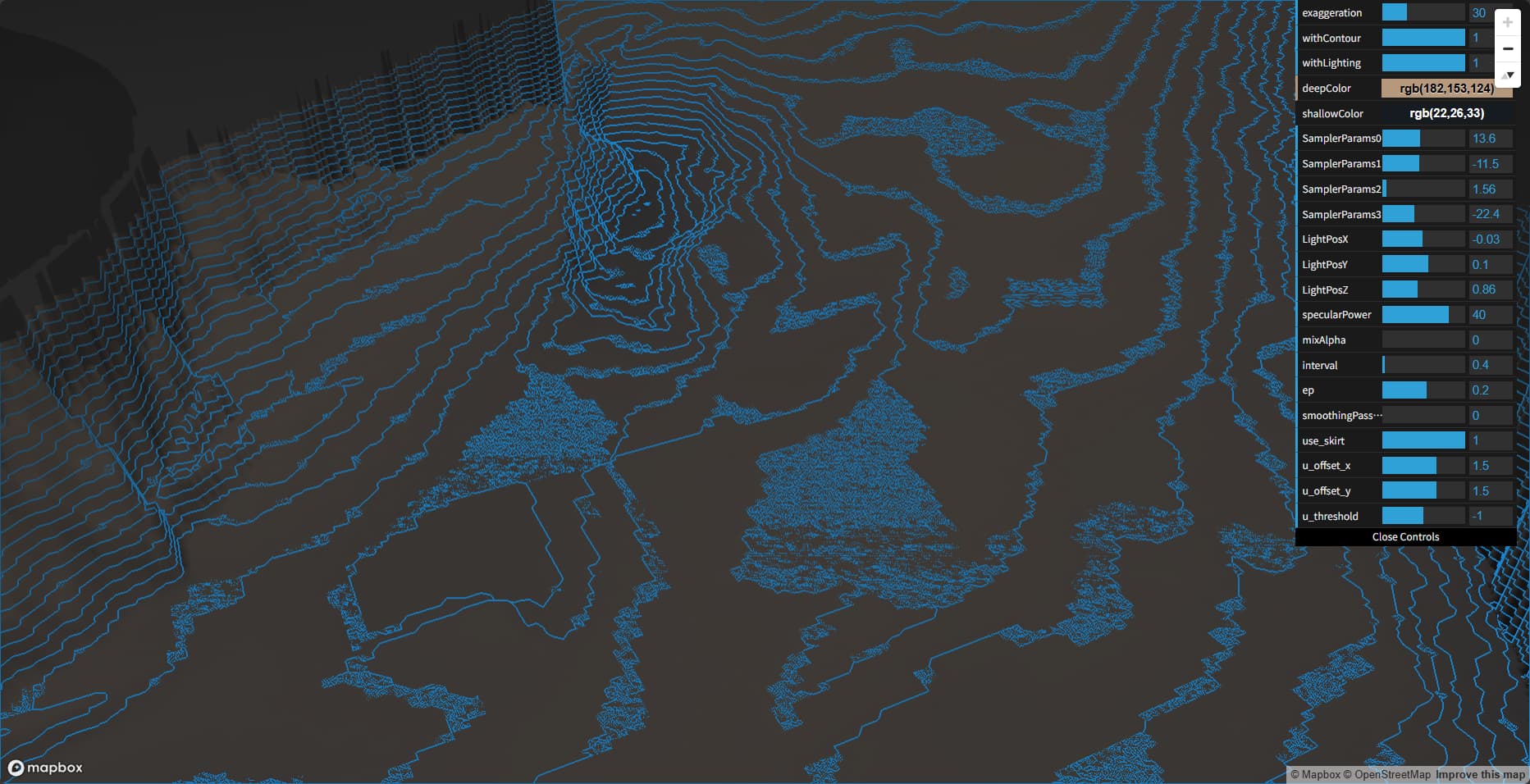

如图,在等高线的边缘会产生一些模糊和闪烁,这是我在 Intel (R) UHD GraphicsApple M1上未曾体现的 bug。
As shown in the image, some blurring and flickering appear at the edges of the contour lines—a bug that I have not observed on Intel (R) UHD Graphics or the Apple M1 .
事实上,我通过卷积以确定片元是否是不同高程级别的分界点,即是否应该被输为特定的等高线颜色。此外,在具体实现里,我在GLSL中声明了 precision highp float;以追求更高的浮点精度,但是无法解决问题。
In fact, I use convolution to determine whether a fragment lies on the boundary between different elevation levels—that is, whether it should be rendered with a specific contour line color. Additionally, in the actual implementation, I declared precision highp float; in GLSL to achieve higher floating-point precision, but the issue persists.
我分别在配置 UHD Graphics 630,Macbook M1,GTX 1650, RTX 4050 laptop 的四台电脑上进行测试,结果表明,只有 N 卡出现了问题。
I tested on four computers equipped with UHD Graphics 630 , MacBook M1, GTX 1650, and RTX 4050 Laptop, respectively. The results show that only the NVIDIA GPUs exhibited the issue.
