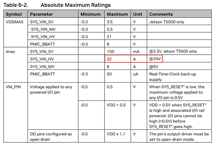

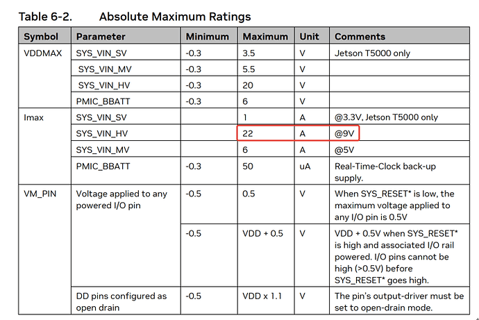

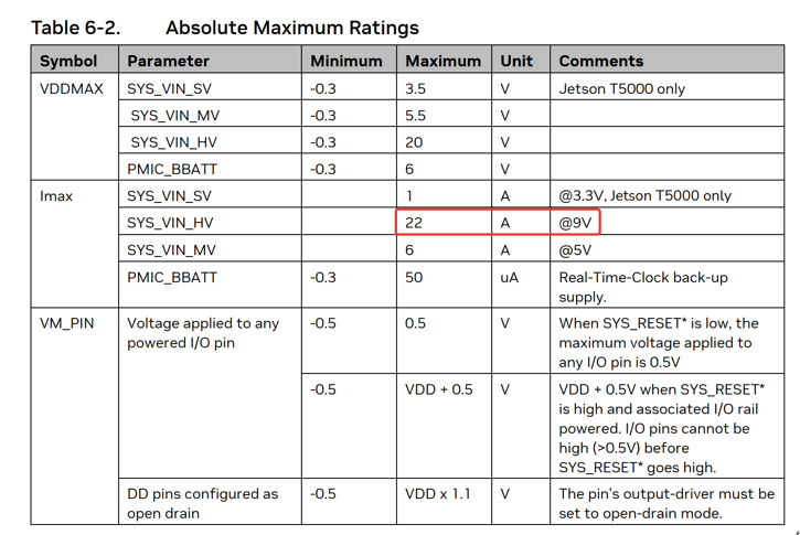

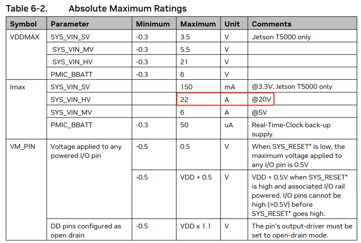

a) What is the reason for such a significant increase in power requirements for the SYS_VIN_HV power domain (between datasheet versions v1.3 and v1.4)?
b) What is the duration of the power consumption pulse from the SOM on the SYS_VIN_HV power domain, and how frequently (within what time window) can it occur?
Datasheet version v1.3(Jetson‑Thor‑Series‑Modules‑Datasheet_DS‑11945‑001v1.3) :
Peak power Pmax_1 = 9V @ 22A .
Datasheet version v1.4(Jetson_Thor_Series_Modules_Datasheet_DS‑11945‑0 01 v1 .4):
Peak power Pmax_2 = 20V @ 22A.
